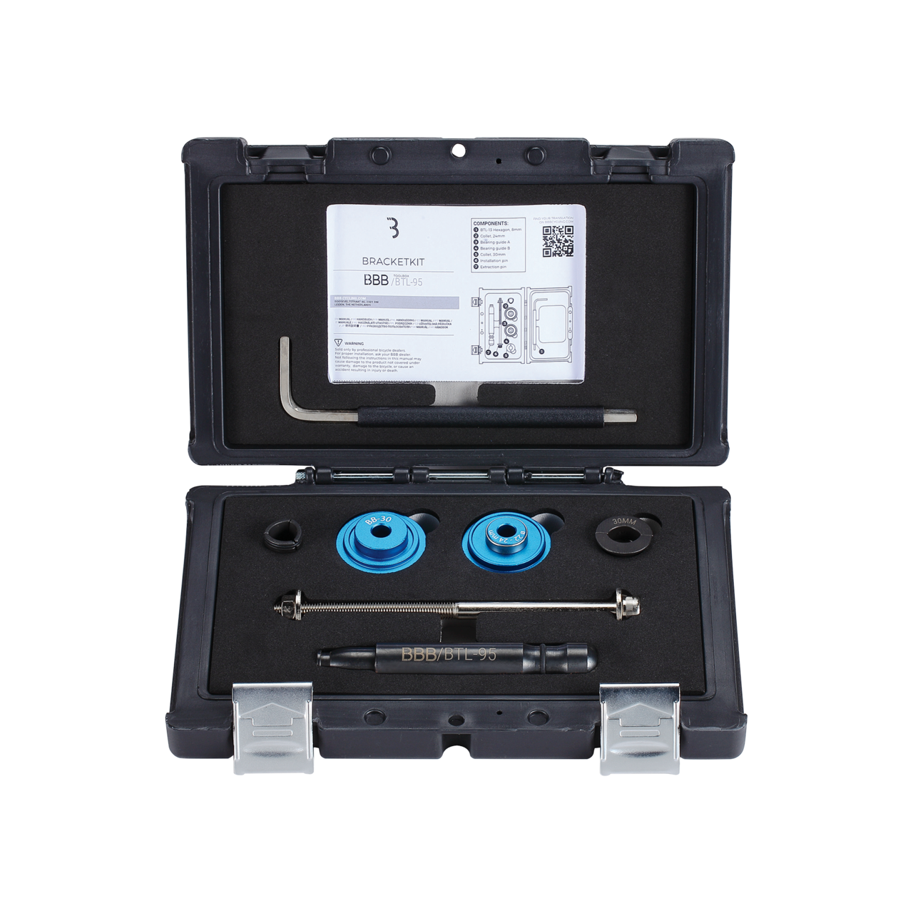

Posts: 4585
BTL-95
Since I have a few bikes with press fit BBs I invested in this. Removes and fits press fit BBs. Well worth it.

Update...
This tool doesn't work. It's diameter is too big to go through the BB with the bearing in so that's been returned. I just used a drift and hammer. On one side the bearing popped out and on the other the cup and tube popped out so you could just remove the remaining cup with the drift too. Took all of 2 minutes.
