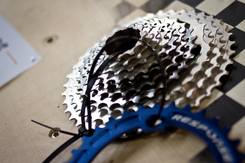

Another pic of the TrickStuff 11-40 Cassette
Posted : 10/09/2013 11:46 am
Posts: 71
That looks good, could definitely be tempted by that.

Is it me or are there only 9 cogs on that Trickstuff cassette?
Posted : 11/09/2013 6:49 am
I'm running a GS mech, my dad has a SGS on his Superfly so I might try that and see if it shows any improvement
I tried the same thing with my wife's SGS mech. Much the same.
Posted : 11/09/2013 8:31 am
Tried the SGS mech...exactly the same issue like Robinlaidlaw above, oh well looks like I'll have to just persevere
Posted : 11/09/2013 11:10 am
I was thinking that...
There's definitely 10 in this image though:
[img] ?1378260188[/img]
