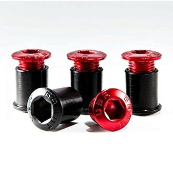

Posts: 4467
Hex/Hex ones like this are the way forward, means you can nip them up easily if they come loose mid-ride.
Way better than the old slotted design that's a sod to work on and which you won't have the tool for if it work loose in the back of beyond.
Nowt wrong with Alu ones unless you're a serial thread stripper.
