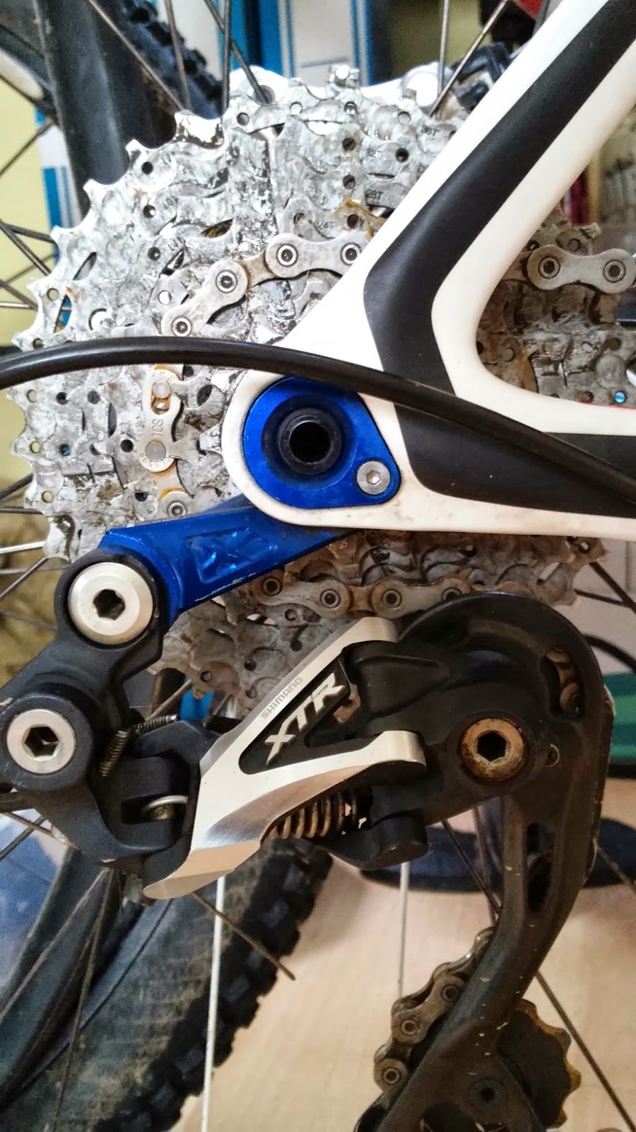

Have you got some photos of your set up with mech attached?
Posted : 27/01/2015 9:25 pm
Cassette and chain are about to be replaced, which is why they haven't been lubed. LBS set it up as last-minute emergency for race on Sunday, they had to set it up so I couldn't use the biggest sprocket, and it was ghost-shifting like crazy in the middle cogs until finally the chain snapped.
There's also some issue with the screws apparently.
It's a Cube Elite XC bike, 2013 model with 2014 replacement frame.
Does this look wrong?
Thanks for showing an interest!
Posted : 28/01/2015 10:38 am
Yes that is wrong, your mech needs the B link removing, as they're designed to be a direct fit.
There won't be any issues with any screws if it's bolted on properly!
Hopefully the pic below should make sense?
Posted : 28/01/2015 10:57 am
Thanks, you're a star. It's all very obvious now even to a clutz like me. I shall be having words...
Posted : 28/01/2015 11:08 am
No problem at all. (FWIW I work at The Trailhead that someone else mentioned above-if you need any work doing, you know where to find us..)
Just take the mech off, flick off the retaining clip (back of the B link bolt), undo the bolt, remove the link & bolt it back on & index. Takes about 5 minutes.
