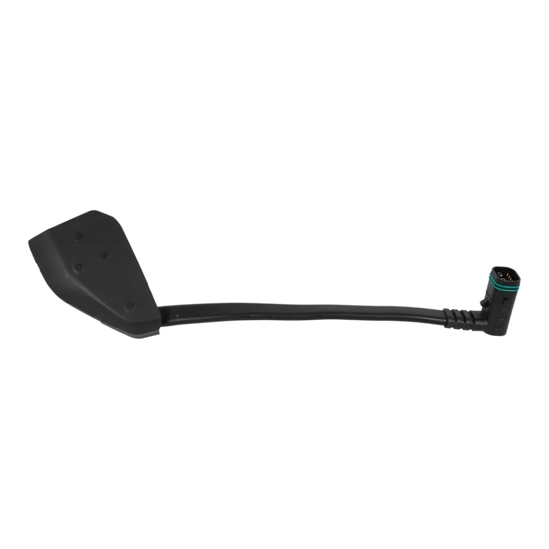

Posts: 2299
Im guessing you have checked and cleaned the Rosenburger plug (its magnetic) and the battery connection?
Also worth removing the plug from the motor and checking the connections in both
The 2020 Levo comes with a round cable with a black sheath cable tied on to help stop water ingress etc.. and it needs to be bent to fit in the small space and cause problems like this over time
The newer cable is a flat one which is meant to improve things
https://www.francesconibike.com/en-gb/products/cavo-alimentazione-specialized-turbo-levo-gen2-150mm-s226800018?srsltid=AfmBOooLxO_nzLwvjQ1LrhDLg9zWQHFBCWxdJDeXWxrEp-6YPZtKjckR

Posts: 1896
Yes, not had that problem but only ever cleaned engine with a damp cloth, cable failed after about 3.5 years (worked perfectly, put away then wouldn’t switch on at all, tiny flicker of 1 blue led but nothing else happened) so cable replaced, I now clean the plug in area with cotton buds every so often and the dealer suggested taking small plastic side cover off and cleaning/drying in there as well.
* I think there was a hole underneath (*poss in the plastic cover )that I seem to remember allowing access to some uncovered wiring, I taped this over a bit, in a sort of overlap style with the intent of allowing water to drip out but not splash in through the hole , ***vague memory)
Also check the cable entry point hole on your swing arm, mine has a sharp edge so I added some rubber seal round the edge to protect the cable.
