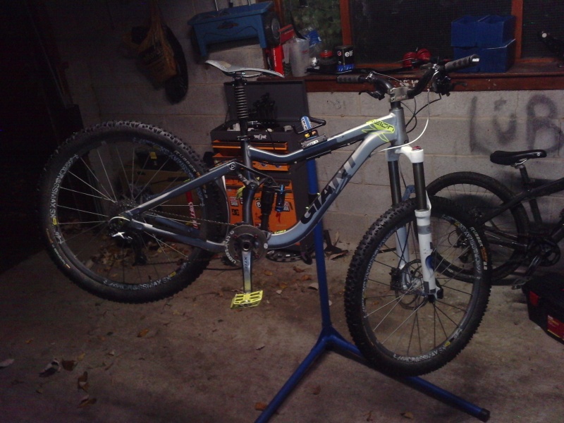

Had my 2010 Reign-X frame since about Sept last year.
FSA Crown race adaptor with 1 1/8 Lyriks no problem.
Have just swapped out the DHX Air 5 for a coil DHX 5 - Air was ok though did seemed to blow through most of it's travel on small bumps. I really use it as a downhill bike so coil seemed the better option + so far seems to be giving a smoother ride than the air. Saying all that plenty of people seem to get on well with the air so give it a try.
Was not a lightweight build so comes in at about 36 lbs - duel ply tyres, coil forks and shock.
Biggest tyres have been Minion 2.5" plenty of clearence at the back.

Air all round, single ply tyres, plus lighter bars, pedals, cranks etc, etc - you could easily get to around 30 lbs.
