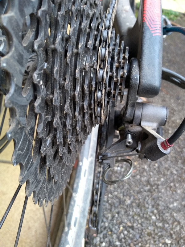

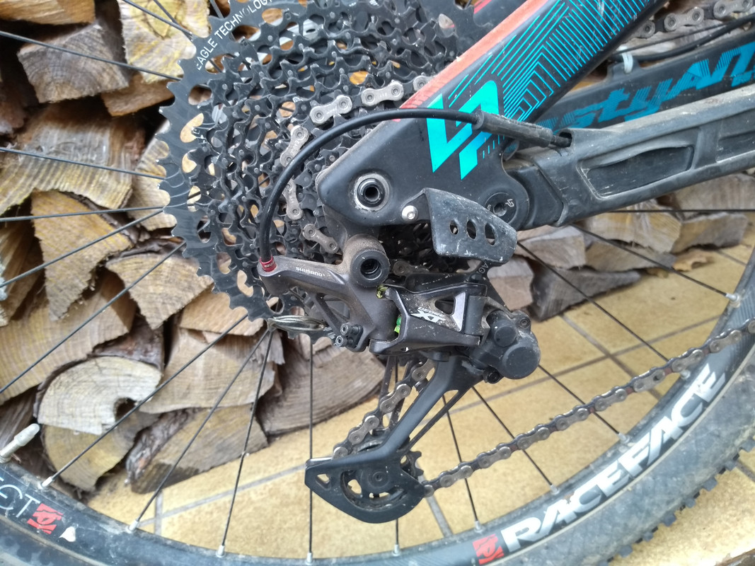

Fitting new XT 8100 drivetrain this afternoon - onto an Orbea Oiz.
Can anyone confirm whether the 10-51 mech is direct or standard mount? I thought Shimano mechs were direct but the new hanger I have looks all kinds of wrong (and I can't line the mech up with the big sprocket even with the limit screw wound all the way out..)
Plus this evidence...
From a singletrack Shimano 12sp review (on an Oiz)
[url= https://live.staticflickr.com/65535/49630986557_06127b5514_c.jp g" target="_blank">https://live.staticflickr.com/65535/49630986557_06127b5514_c.jp g"/> [/img][/url][url= https://flic.kr/p/2iBHMbM ]hanger[/url] by [url= https://www.flickr.com/photos/76951366@N02/ ]hutchinson2017[/url], on Flickr
Somewhat jaunty on mine...
[url= https://live.staticflickr.com/65535/49630988647_2800a7231e_c.jp g" target="_blank">https://live.staticflickr.com/65535/49630988647_2800a7231e_c.jp g"/> [/img][/url][url= https://flic.kr/p/2iBHMNP ]IMG_20200307_152512_1[/url] by [url= https://www.flickr.com/photos/76951366@N02/ ]hutchinson2017[/url], on Flickr
Posted : 07/03/2020 5:19 pm

Posts: 21739
Looks like you have a direct mount drop out but a standard mount rear derailleur. I believe Shimano doesn't offer direct mount for 12 speed so it looks like you'll need a new drop out for your frame.

Thanks!
Next stupid question - will the hanger that I took off with the SRAM Eagle stuff and chucked into the corner do the job, or is that yet another standard?
Posted : 07/03/2020 7:23 pm
Posts: 21739
Yes. Hangers are either standard, or direct mount.
Posted : 07/03/2020 7:26 pm
Posts: 28602
Great, only wasted nine quid then. Which is a result these days. 🙂

Posts: 3878
The direct mount style won’t allow the parallelogram geometry to allow the spread of ratios that people want, so they reverted to a traditional layout - albeit still lower profile than Sram mechs.
