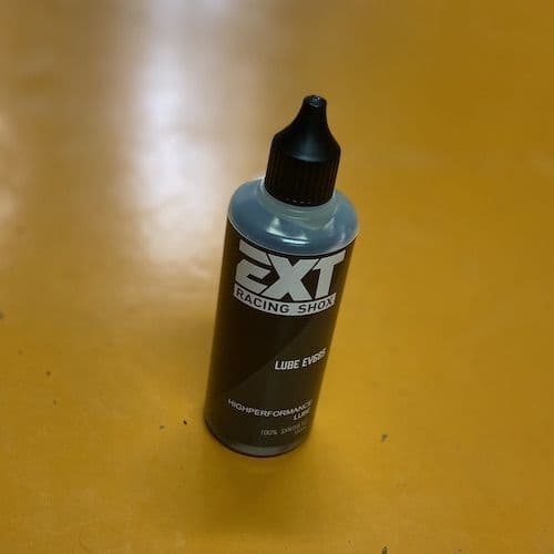

A new fork that feels wrong needs opening for an expert check over and proper lube I reckon. Lack of confidence once something is perceived to be wrong spoils every ride I reckon.
I use the EXT “super slippy” lube - it’s a small bottle with a dripper nozzle and a pick / seal opener tool - to lube the fork seals. It definitely makes my Zeb feel smoother.
Get it as a kit from Mojo Rising / Geometron Bikes near Monmouth.

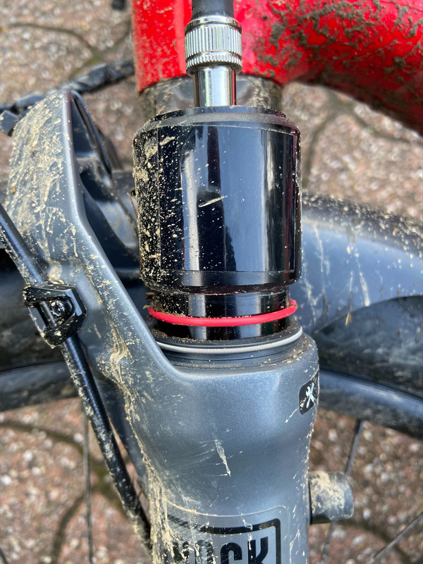

This is the max travel I have:
[url= https://i.postimg.cc/43GGHvvX/fork-travel.jp g" target="_blank">https://i.postimg.cc/43GGHvvX/fork-travel.jp g"/> [/img][/url]
If I set the sag correctly for my weight and then take the weight of the bike off the fork I measure the stanchion at 170mm. however looking at the above pic with the O ring showing the max travel Im losing about 5-6mm of travel overall.

Why would you want to smash the seals into the crown at bottom out?
I wouldn’t expect to get anywhere near full travel on a 170 fork at a trail centre and have the bike ride decently.
A common misconception with a harsh feeling fork is to reduce pressure and compression but all you’re doing there is getting into the progressive part of the stroke sooner and have no hydraulic help to hold you up, it’ll also slow you’re rebound down making the fork not able to recover after bumps correctly
Posted : 06/11/2022 9:40 pm
Posts: 7226
5-6mm is the wheelhouse of the bottom out bumper
