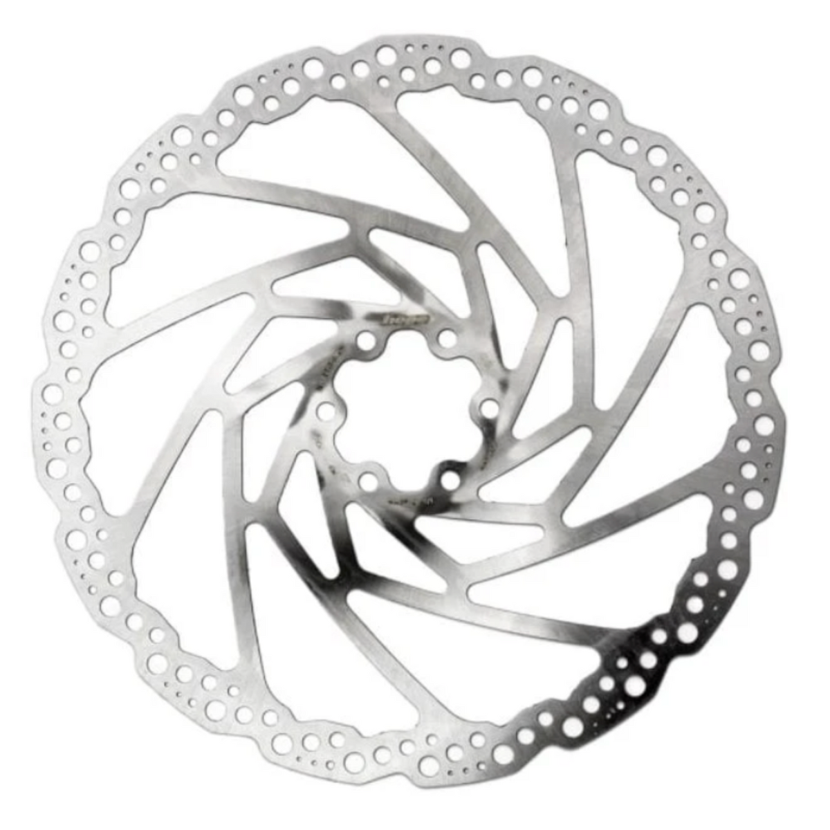

Posts: 44
I'm using some hope standard rotors, 220 front and rear. They are 2.3mm thick. Any 180mm and bigger are 2.3mm. I think TRP do some fancier ones as well.
https://www.totalbleedsolutions.co.uk/products/hope-standard-fixed-disc-rotor-6-bolt-120-140-160-180-183-185-200-203-205-220mm?variant=45248875331893
