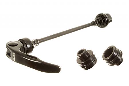

You say youhave some 15mm to qr adapters but they probably won't fit all hubs , I ran a [url= http://www.chainreactioncycles.com/mobile/nukeproof-conversion-kit-15mm-to-qr/rp-prod80192?gclid=CjwKEAiAz4XFBRCW87vj6-28uFMSJAAHeGZbB5LLohAWzqC-yM_LdZ7qX82Afg503XZKrL4abDO9RxoCQlfw_wcB&gclsrc=aw.ds ]Nukeproof adapter[/url] in a set of DT Swiss wheels for ages before a bike upgrade with 15mm forks . The Nukeproof one will fit any 15mm hub without causing any issues as its essentially just a bar with a hole in it.

Posts: 1735
Thanks all. Can't find the link to the adapters but they look like these:
