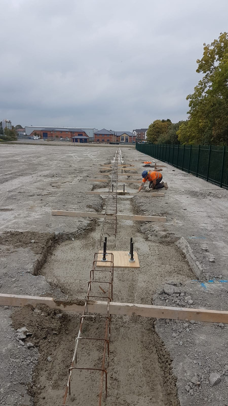

    C28/35 last week at £68.32 a m3 on special, usually £72.38 but we had a little fall out, put just short of 700m3 in the ground over the last 3 week’s. I did forget the vat bit tho and quoted on my prices. Anybody paying over 75m3 plus vat for a basic found C16/20 on a blend with big quants is being ripped off. C40 was for the floor slab with mesh, 900 deep for founds was just an average punt on ground conditions for pricing. But hey what do I know 😉
    wrightyson
    Member
    Oh and here’s some I put in earlier this week, just for the non believers. Check that bolt line 😉
    ^^ where in the UK?  I’m intrigued (in the price).
    wrightyson
    Member
    7 miles out of derby.
    Hmm, in rural Devon there obviously isn’t enough supplier competition.
    That’s going to be a big garage when it’s finished…..must be for trail-rats campervan

    Your building Wrightyson is a huge commercial warehouse with 900 deep founds, 18  tonnes of concrete to be barrowed around the back garden of the house will take a wee while longer than half an hour and c40  for the floor slab would be setting and unworkable for a novice, what about added cost of bunyan, dumper, and power float. Expensive garage this is working out
    40 mpg could price this job for us
    wrightyson
    Member
    Ok redmex, lay a shitty c20 for the floor with a blend and wait 4 hours before you can get a trowel on it in autumn/winter. Ideal that.
    And btw my strip founds are 450 deep and column bases 600, tsall about the ground pressure.
    My “advice/costing” was all a bit 6 am this morning and a bit broad within it’s spectrum admittedly. If it’s worth building build it properly, please see the other thread about the single skin garage pissing water in.
    Only trying to help after all.
