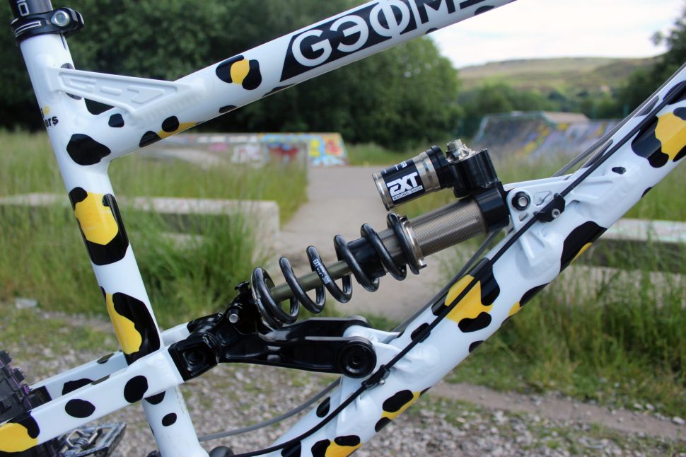

As in what got changed, why and the differences it made? Love the paint job👍
