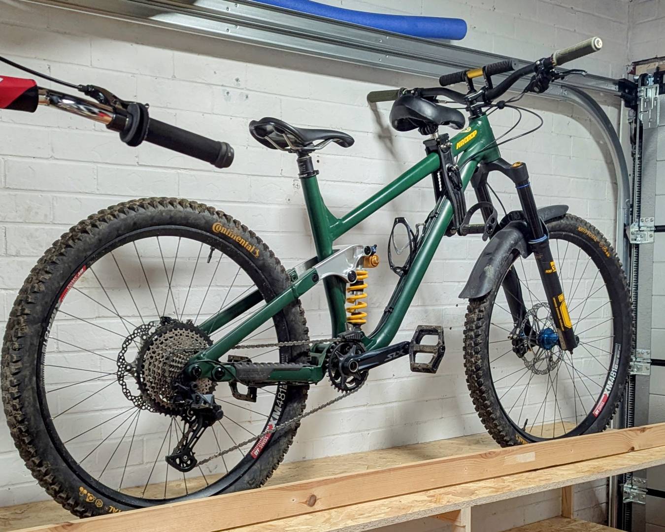

I've got an Airdrop Edit MX and a trail bike so the Edit is 90% bikepark/uplift/DH bike. It's a nice bike, it's planted, grippy and quiet. I was just wondering if I could remove some of the chain flappyness which causes the only noise and annoyance on the bike.
I feel like 'pedal kickback' is a bit spurious and not the big issue that some people make it out to be. But, chains are heavy and they definitely whip all over the place when you're descending on chunky trails. If I could mute that a little I'd be happy. Maybe not £280 happier though.
I wouldn't mind one in time for BPW next month but they're pricey enough that I might wait until Black Friday!
I don't have any recent riding pictures but here's the Edit in Dad-Mode.

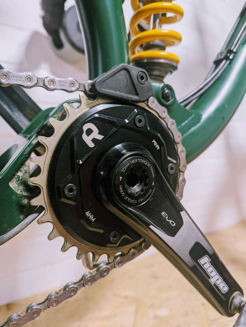

  IMG_3439.jpgIMG_3441.jpg Yes fitted one to my DH bike, its a weird feeling pedaling with it at first but you adapt quickly.
I had a bit of a faff making it fit with the chain guides, the picture shows how much it touched but I spaced it with a bit of fiddling, but that could be down to the DUb Wide bb?

Posts: 1150
Top Guide will be absolutely fine then, it was only the bottom guide that was snug.
For my Dissent it is a lot quieter and felt smoother it hasn't had many outings yet.
