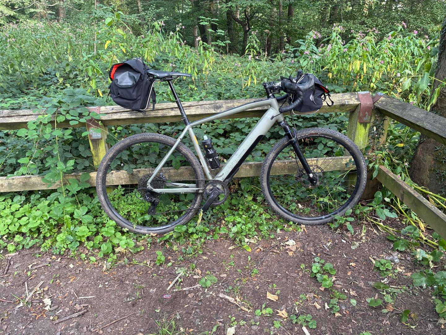

 Outfitted Cairn.jpg I've been running Ekar GT, 10-44t, with a 44t on my all purpose eGravel bike for about 2.5 years. It gets a fair mix of road, canal path and bridleway, mostly without the battery and motor in tow (most of the Fazua system is removable in seconds). Unaided it weighs about 30 lbs unloaded (dropper, sus fork, rack, tire liners, double wrapped bars, big steel bell, etc.). Unaided, I have found that the 44t to be too difficult on steeps and I rarely use the 10t. If I had a lighter bike with less rolling resistance (I'm on 45mm) the combination (or an equivalent 9-42/40t combo) might be perfect. As it is, I've just ordered a 40t from China to avoid having to pay 90 quid for an Ekar (13sp chainrings are different). The Ekar brakes are fabulous, though I bumped up the rotor size because of mine and the bike's weight. I didn't like the thumb hook shifters at first, now I think they are great. Campy consumables (chains, cassettes, brake pads) can be expensive, but are often on sale and there are some other options.
